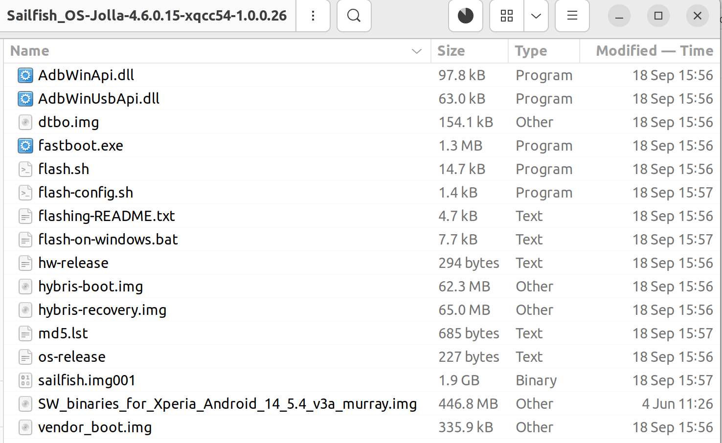

Xperia 10 IV
Check that the contents of the flashing directory are like in the picture below.
  • Flashing directory Picture 11: A flashing directory (here: Xperia 10 IV [xqcc54] and OS version 4.6.0.15)

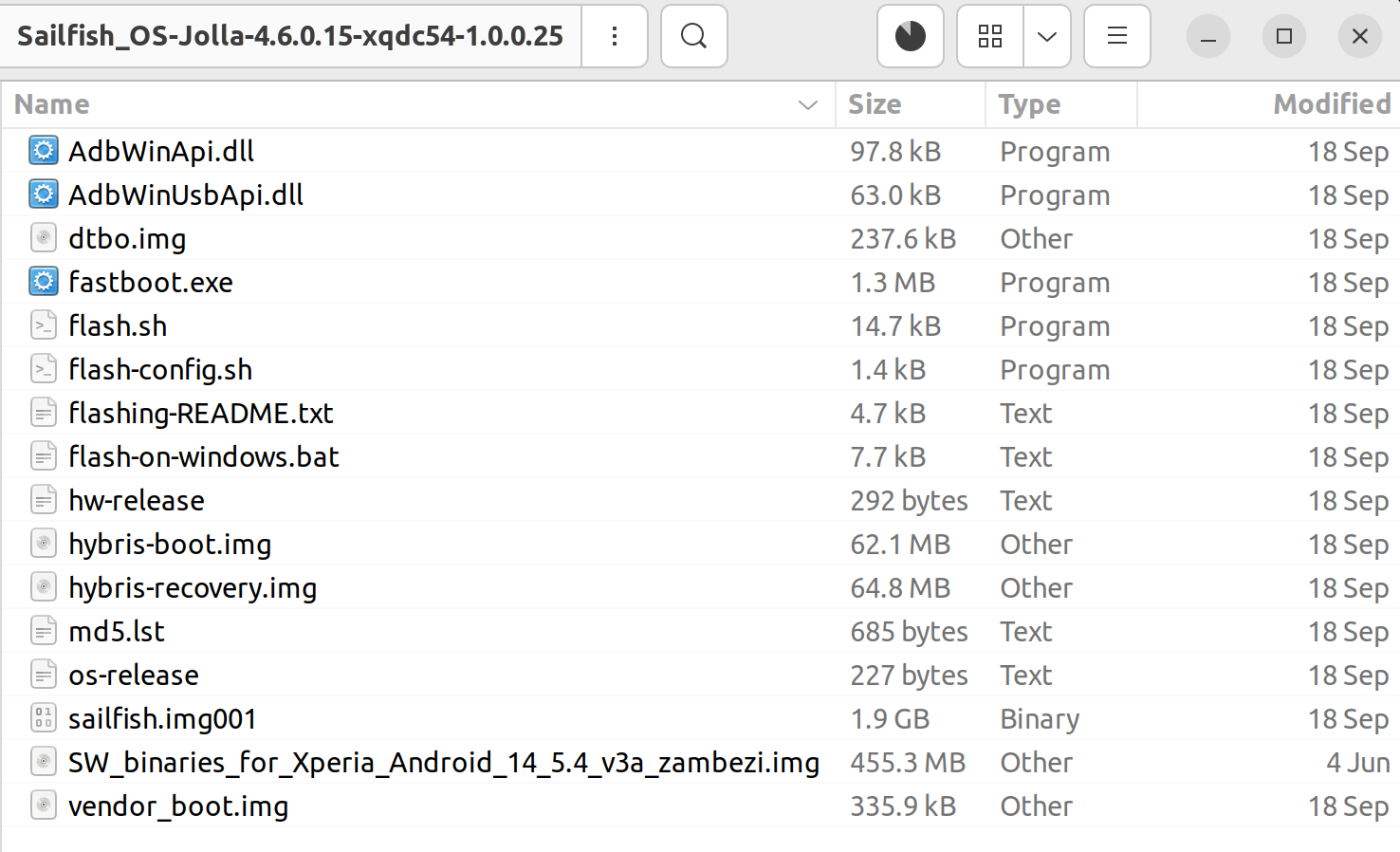

Xperia 10 V
  • Flashing directory Picture 12: A flashing directory (here: Xperia 10 V [xqdc54] and OS version 4.6.0.15)
